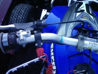

i have mine grounded and try to put your tether up by your cultch lever. i got a tether for 7/8 bar and mine is 1 1/8 i made it work ill put a pic on here

if you look at Davenports picture, mine is mounted where he has the blue zip tie.
I got mine to fit best on the other side of the bars, right next to the brake perch. I'm pretty sure mine was made for smaller bars, not the tapered ones on my 07.
Am I going to have any problems with it there that I'm not thinking of? Thanks for the help guys!
The tether doesnt care if you mount it on the bars, the frame, grab bar, you get the idea. The point is does it work when it gets activated and kills the motor.
