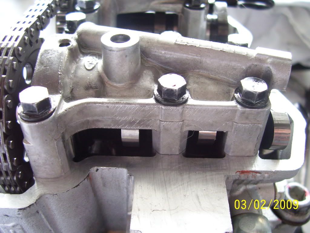

Intake cam should look like this when at TDC
exhaust cam should look like this at TDC
Both cams
if yours does not look like this you have problems as started above. if it does look like this adjust your vavles and it should start up, considering everything else is good
