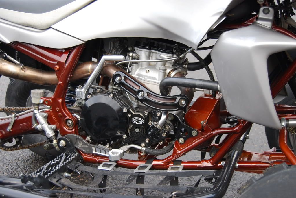

Here is what i did with mine,
I Had to drill the hole in the rezzi a little large for the bolt, but I put a about a 1.5 inch long bolt through the old fender mounting tab there, slipped the rezzi onto it and then pinched the rezzi on with a nut and washer on the back side. I have never had an issue with it like this for close to 4 years now.
Is what i did, is i took both fender brackets off. I "v'ed" the bend on the right side bracket, bent it almost 100% straigight, re mounted it on the left side. Now there are two holes on this bracket. i mounted my rezi to the bottom hole and the nice thing is, this keeps it away from the swing arm and the exhaust so it doesn't heat up the fluid either, now no brake fade during a long moto or long rides :)
Hope this helps
QUOTE (Oregon450Duner @ Mar 23 2009, 11:05 AM) index.php?act=findpost&pid=761035
I Had to drill the hole in the rezzi a little large for the bolt, but I put a about a 1.5 inch long bolt through the old fender mounting tab there, slipped the rezzi onto it and then pinched the rezzi on with a nut and washer on the back side. I have never had an issue with it like this for close to 4 years now.[/b]
BINGO!!!! I wish you lived closer....I would buy you a beer or 12.
Did your stock reservoir have the spout on the bottom like that, because mine has the spout on the side.

I kind of get what your saying, if you had some pics that would be awesome.
Mine is an 05 so the rezzi has the nipple on the bottom. I bet you could get one for an 04 or 05 off of ebay for a reasonable price.
