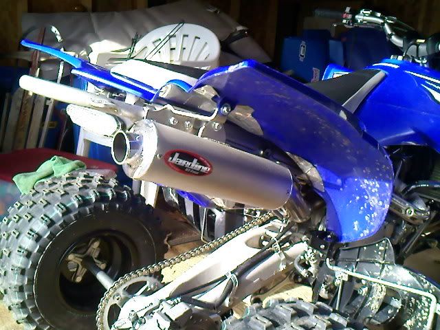

Well I just put on my new Jardine RT-4 earlier today and WOW!!!
I threw on the pipe (its a slip on) and removed the intake lid and re jetted then took her for a ride. I can't believe how much this bike picks up with that little bit done to it.
For Jets I picked up the gyt-r kit and have the needle on the 3rd clip 168 main and 45 pilot with fuel screw just past 2.5 turns. Next mod will be the cam mod.
This is no real point to this thread other then I am really happy with the exhaust.
Sound is amazing and the power is great.
Here are some crappy cell phone pics

If you get the header it will make more of a difference than the slip on did. I'm sure you already know that though.
yeah I know but I didnt want to spend that much money right now.
Good choice for pipe IMO.
FYI. Jardine doesn't make the RT4 anymore and so finding a RT4 header for it will be slim to none. The new yfz Jardine pipe is the RT5 and it too is a very good pipe.

Yeah I know they quit making it but thats why I picked this up. I got the pipe for dirt cheap and was still new in the box. Once I get tired of it I will save up and buy teh RT-5 full set-up
Or just stick to that header and pipe combo. The stock header isn't all that bad IMO.

yeah it will be the last thing to get changed. I wanna get a better filter and do the cam mod. I still got a lot to buy before that will happen.
