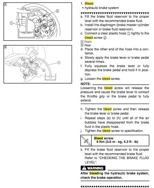

Sidewinder, where did you find that diagram. Is there a link to the whole manual?
Disreguard that lol... Your sig has good information in it
you can also speed this process up a little by letting it gravity bleed. just fill the reservoir, and crack the bleed screw and wait, gravity will pull the fluid down slowly till it starts bubbling out the bleeder, once you get fluid, start the pumping and cracking process to get the air out of the line.
