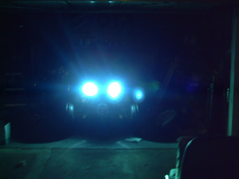

heres a shot of mine on the R.
which kit is this, i want hid's and this looks pretty sweet.
Well it is installation too, I didnt wanna mess with it so I just had somebody do it that knew what they were doing. It does use your stock housings just taking out stock bulbs, re wiring into your stock harness, new dust covers, and they come with a one year warranty.
