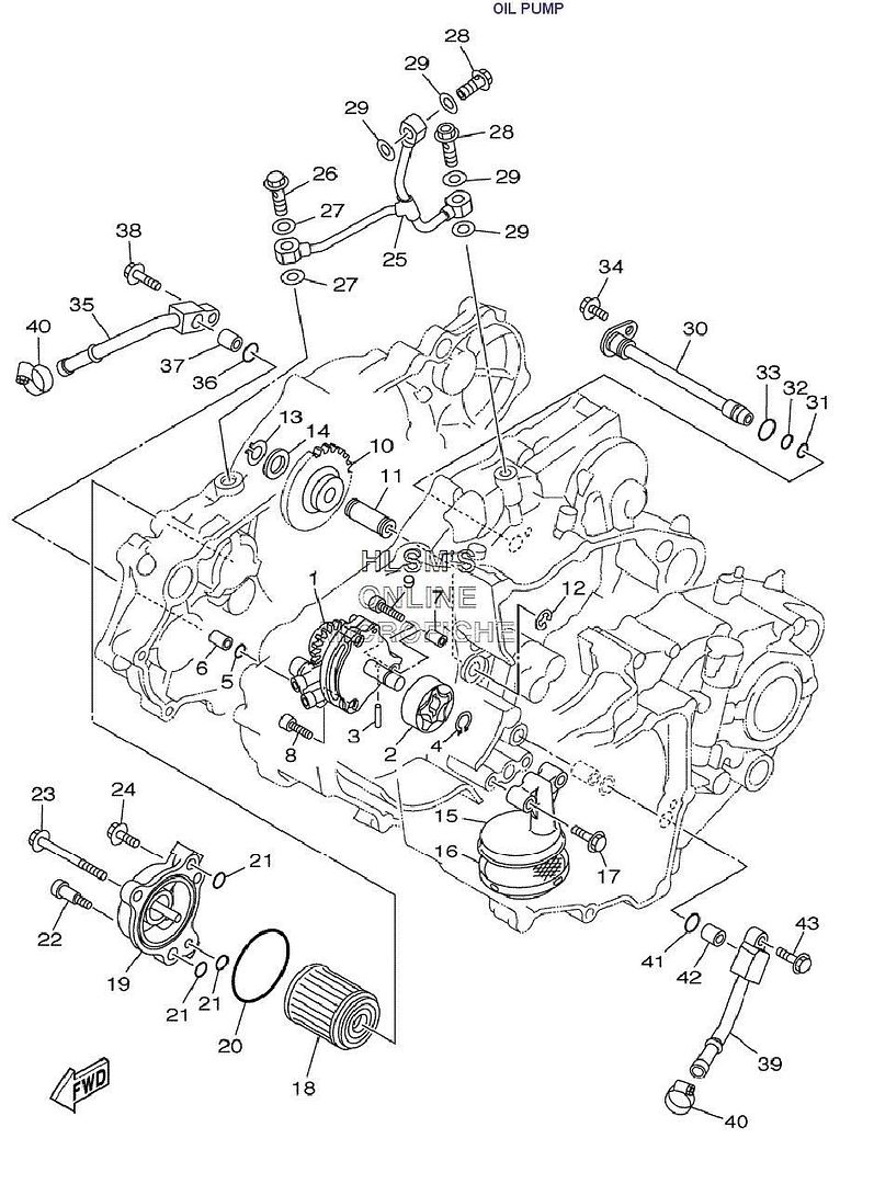

and Bel-Ray waterproof grease - you use this instead of the Lithium Soap Based grease? i need something equivalent to it, if not that exact grease. i need to grease up an o-ring on my oil tube. maybe you'll know what i'm talking about. the oil tube on the brake side coming out of the case at the very bottom. acyually located pretty close to the brake pedal. its a machined conection to the case and a soft hose going to..........the tank........i think.....
i have a slow leak/spray when the motor is running. its says in the book to grease the o-ring with "Lithium Soap Base Grease."
i have some Shell Alvania EP 2. does anyone know if that will work? its a lithium grease.

I'm pretty sure the oil line your talking about also has a couple of brass washers that are installed with it. If it is squirting like that, make sure you have those brass washers installed as well.
its # 35-38
there is not brass washer, its the o-ring. i guess i'm supposed to grease it.
I would suggest replacing the o-ring and sleeve (#5, #6). Sometimes lubricating the o-ring will help, and sometimes it just needs replaced. I would also make sure you use the right lubricant. The stuff you have may work but it's always better safe than sorry in my book. I'm sure you will, but make sure you torque to spec. as well (I think its about 8-10 lbs for that bolt - can't remember exactly)

i would replace the o-ring, but i don't think the dowel needs to be replaced.
i really think it just needs to seal.
and the torque in 8nm - its very little. thats why i think the sealant is so important.
I only say the dowel too because I have scratched one before which caused a leak (I would rather tell you to replace too much than not enough). Mine was from someone accidentally sliding it on dirty pavement, creating a deep groove which in turn allowed a leak. You hopefully don't have to worry about something like that.

I'd check the o-ring for sure, possibly even the one inside the case (#5) if you have it off for any reason.
