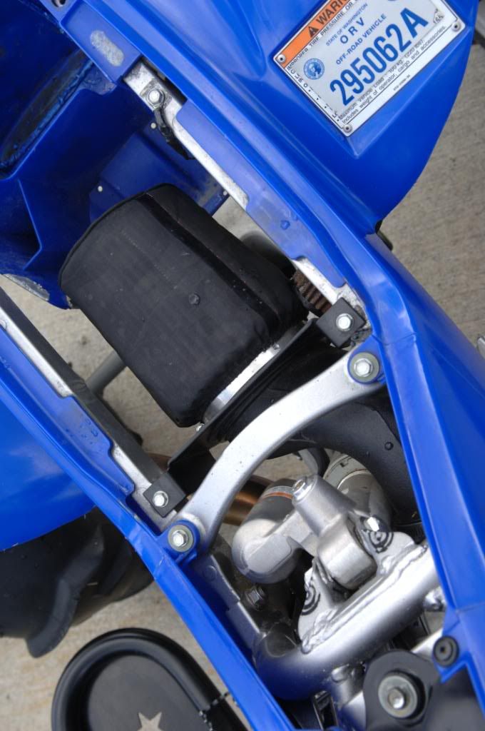

Here's a pic of a another kit installed in my doggie, Grant's YFZ, notice the intake ring...

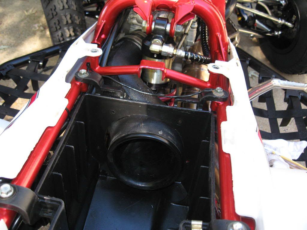

This is a pic of the kit that I just bought...

Your intake looks just like mine. So, if your missing something then, so am I.
SO I'm assuming that you just mounted the filter directly to the intake tube :icon_eek: ...
If so that just dosen't seem right to me man. I'm curious as to why I didn't get that intake ring with the set screws in it. I plan on using this set-up without my air box, but IMO rubber to smooth plastic contact aren't gonna hold up for MX.
Not missing anything Chris. I've seen 3 FCI's in person, including mine, and they all mount the filter directly to the intake tube. The correct way to mount it is to put the filter on intake, and slide the filter forward far enough so it sits inside the mounting bracket ring.

Your not "missing" anything, but it looks like you have the kit with out the filter side plastic velocity insert.
I run what you have and don't have any problems with the filter coming off.
