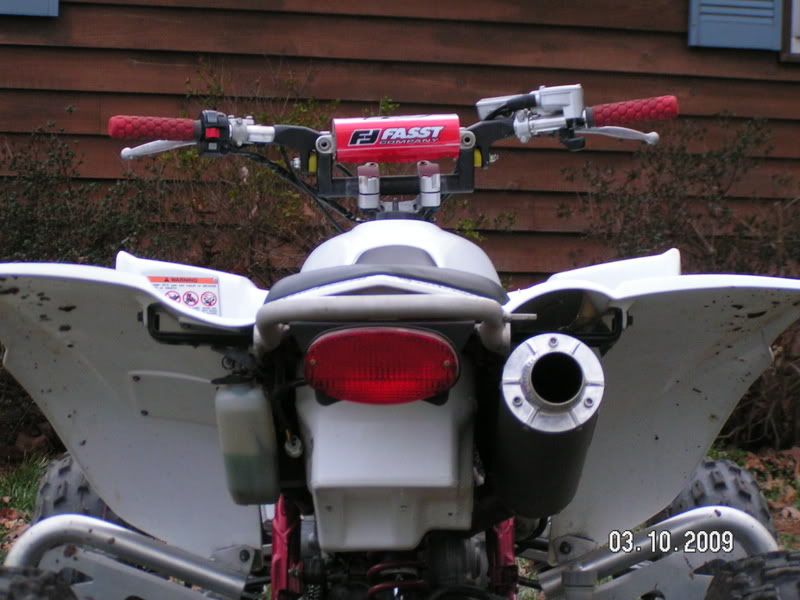

I dont see it making to much of a difference on which u choose. I dont even know what mine are and i like them. 14* 31.5" is all i know. Not sure about high, mid, whatever. Heres a picture, on stock stem.

I'm thinking of the dana creech bend? 14 degree bend? What are the specs of them.
Also I am just guessing those because.. well.. he doesn't seem too big, (my size) and they are for a quad.
I guess I can't go wrong with that style? Any feedback or opinions on that?

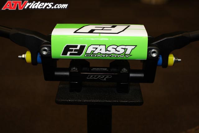

The rebound cushions help minimize vibrations transfered threw the bar while you are pulling back on them. All it is is one cushion on the inside of the bar and one on the outside. Here is a photo.
Thank for the picture, perfect.
So if I ordered some does it come with the elastomer things on both sides? I guess i'll just figure it out.
If it doesnt, its not hard to do. I went to the parts store today and did mine. I just took out 1 of the bolts, took it up there, found the same type bolt, just 1 inch longer, and bam. 2.19 later i had what i needed. The only difference is this bolt isnt an alen head on 1 end. I kept my yellow elastomers on the inside and put my blue on the outside. Ive not riden with it yet, but im sure it didnt make it feel worse.
