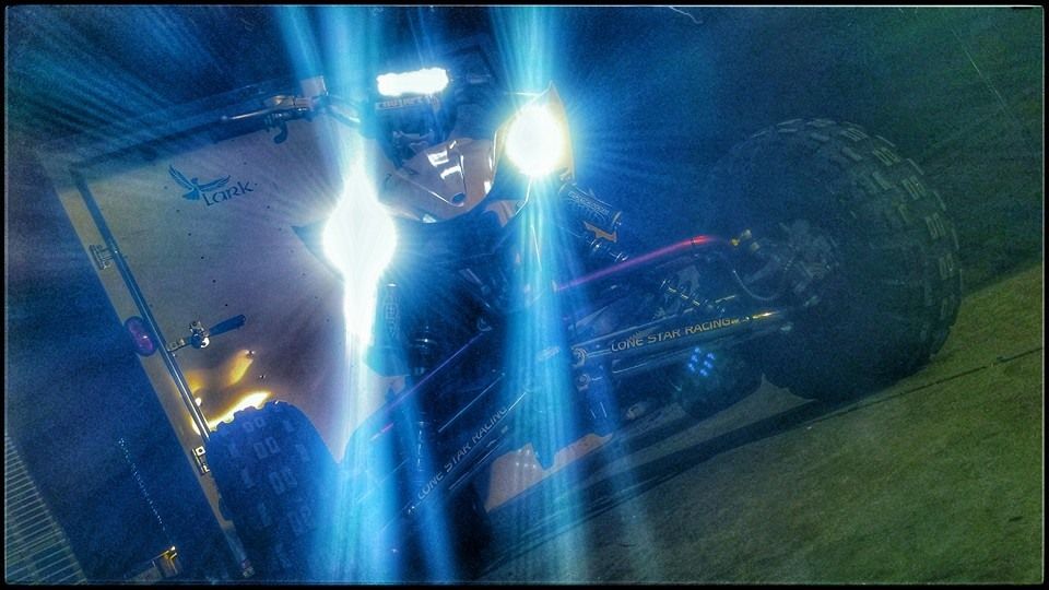

Sorry guys didnt get home till late last night didnt have a chance to grab any close ups but here is a front view. Ill be sure to grab some close ups tonight.
So heres some pictures guys, it pretty simple I added notes on the pics but in short just take the left side mount and put it on the right side and the right on the left grind off the stock nut that is not needed I got lucky enough that the bolt ended up being able to squeeze through the hole that was left so that I did not have to drill it out.
