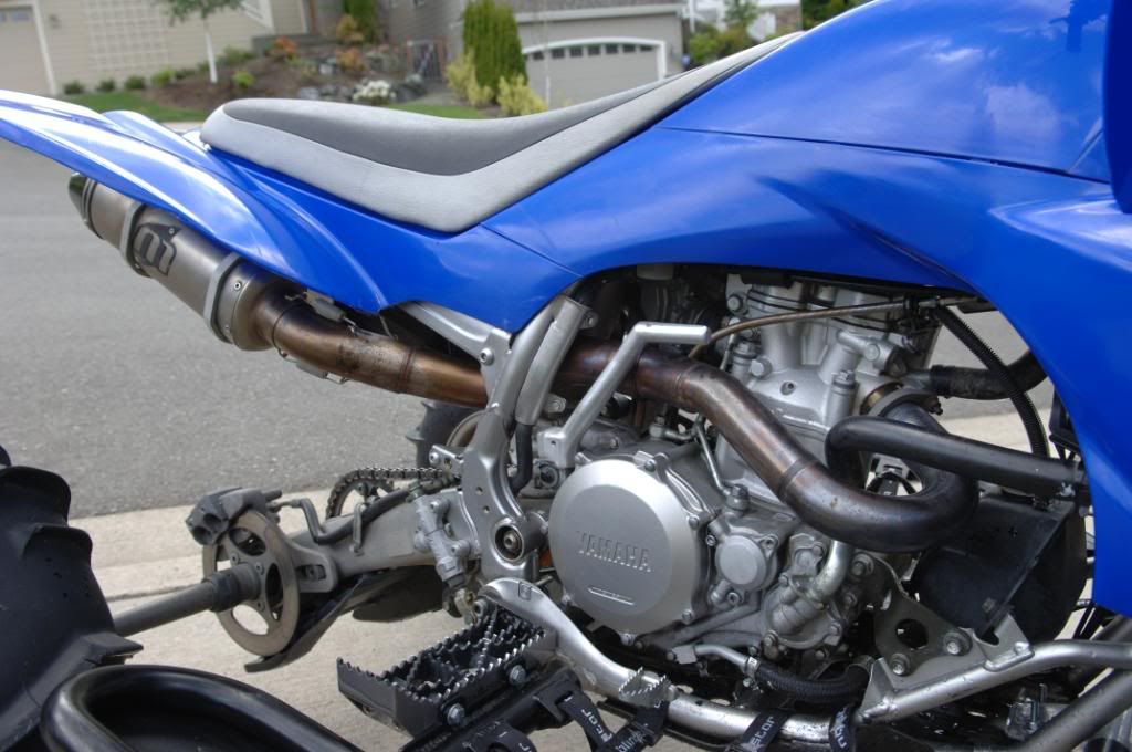

I cut my plastic on my rear fender. I just made sure i gave it enough room for the heal of my boot when kicking .. I was gona make a new bracket for it but it really doesnt need it ..let me see if i can get a pic of mine for ya
whoa sidewinder, a little too much just for a kicker lever, lol, thats drag cut isn't it? I just ordered new plastics from Laker that are kicker cut rear, when they show up i'll post pics for ya, I don't exactly know what they are gonna lok like, lol
Jon
No, they're not drag cut as you can see here.
Here's a pic of the laker kicker cut, pretty similar to how I cut mine.

Trim off enough so you're comfortable with kicking it.

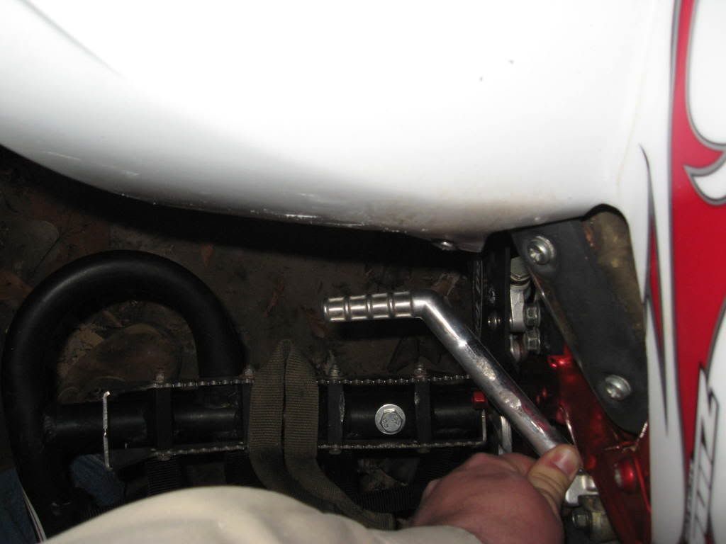

I've got the '98 YZ250 lever on mine, and I didn't cut my fender. The lever I have WILL clear the fender but it's very close. You have to learn to kick it with the very back of your heal but after you get used to it, it's pretty easy to do. I went ahead and bent the bottom bracket back just a tad to get a little more room. But like I said, it's pretty easy to start once you get used to it. I can start my 13.5:1 motor sitting down. Here's some pics for you.

I've got the '98 YZ250 lever on mine, and I didn't cut my fender. The lever I have WILL clear the fender but it's very close. You have to learn to kick it with the very back of your heal but after you get used to it, it's pretty easy to do. I went ahead and bent the bottom bracket back just a tad to get a little more room. But like I said, it's pretty easy to start once you get used to it. I can start my 13.5:1 motor sitting down. Here's some pics for you.[/b]

Grant before you bent that bracket did your lever JUST hit the bolt that holds your fender to the bracket (the one shown in your first pic)? That's how mine is now, so I'm hoping I can just bend it back a little so it's out of the way. I think I need to get rid of the stock heel guards to, but that's ok since they are indeed pretty lame.

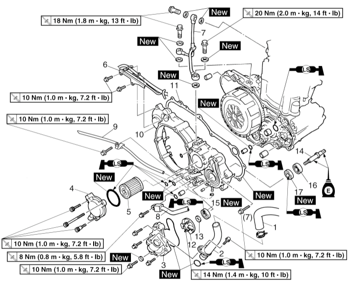

..I should have some time to work on it tonight since apparently I lost the little dowel that goes from the oil line to the side of the case letting all of the fresh oil run out. :shocker:
BTW..are there any dowels that go in the case cover I pulled off to put this kicker on?? I have a bad feeling I either forgot something or put something extra on. Ahhhh, the learning process.

Nope, mine has always cleared. But it clears a little better since I bent the bracket.

Thanks for the diagram Sidewinder, I looked at mine when I got home and realized 2 dowels INSIDE the cover, and none in the outside line, doesn't add to the performance of my quad. I should have taken a pic of those 2 smashed together. Good stuff.
