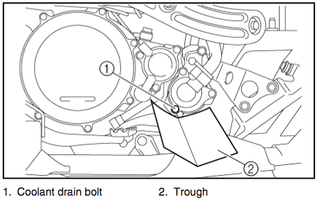

theres a little bolt. hold on, ill get a pic and an arrow. =P

Yes you have to remove the plastics and yes there is a drain plug.
1. Remove side shroud plastics
2. Take off radiator cap
3. Remove drain plug
4. Flush out remaining coolant with water
5. Empty overflow bottle
6. Put plug back in
7. Fill up radiator and overflow bottle
8. Let bike idle, topping off coolant in radiator
i hope your happy, that took me like 5 minutes!

seriously, what is that? a bunch of lines? that is a trough? i dont think so.
Thanks a ton! Found it and going to change it right now. I appreciate your 5 min :icon_biggrin:

I bet you looked at MY picture.

anyway, the way i did my engine ice was:
drain coolant
run white vinegar (?) and distilled water (half and half) for 5 minutes
drain
repeat
drain
repeat
drain
distilled water for 5 minutes
drain
engine ice for 10 minutes
check level of radiator and reservoir - top off if necessary
all that rinsing is to get rid of any remaining coolant on the motor and radiator. the vinegar get all the deposits out and the last step of just water gets all the vinegar out.
your not supposed to mix coolant and engine ice. so i made sure it didn't mix at all.
take the drain bolt out before you take the radiator cap off that way the coolant dont shoot out until your ready for it
