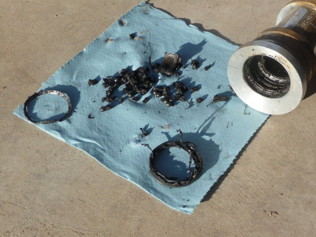

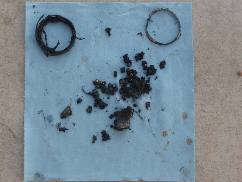

Well my ride was cut short today as I was getting a feel for a small table top. luckily I was just coasting and not going balls out because my wheels locked up off the face of the jump and the wheeler went nose down quick :shocker: .

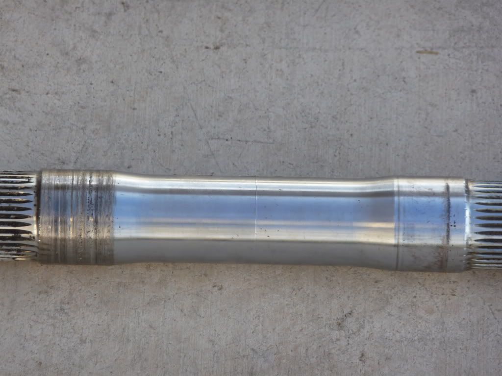

I hope my axle is still useable.....

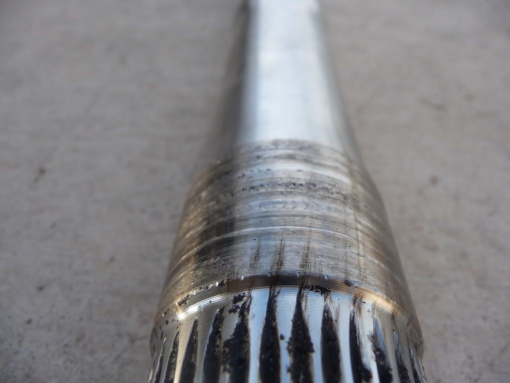

That looks like the last carrier I killed. It was so bad, we ended up having to cut it off with a torch. :icon_eek: I think you axle is probably salvageable. I've seen people run worse, I know that for sure. Just go over it really well with some really fine sand paper or that sanding cloth stuff.
What kind of carrier and axle was that?
933 Posts
ahh your axle should be fine, my rpm looked worse than that when my last carrier blew, just kinda file the axle down so theres no sharp points on it and you'll be fine, when my stock carrier blew out i was fourth wide on my way up to a 100ft triple. ended up stopping sideways at the lip. anyways, what kinda carrier is that? i use SRP's dual row, holds up pretty good with the kinda abuse i put it threw.

It's actually like an 8 month old LSR carrier with the sealed bearings that they are offereing now. They actually didn't need to be greased as the had a plastic type covering over the ball bearings but when I put my quad back together this winter I packed the carrier full of grease any ways to keep moisture out.
I'm also running a RPM Dominator II axle which you guys see in the pics. I'd be really freakin pissed if I new that my $400 axle wasn't salvagable over a $30 Chinese bearing.
I'm thinking that the reason it might have blown is because all the tracks that I've been riding on around here go in a clockwise direction and I've really been working on my cornering lately. Either that or the bearings were made out on a rice patty somewhere in China :strokin:

Sidewinder just went through the same thing. His RPM axle was not salvageable. His grooves where way worse. I was looking at it today and on one side the bearings are completely gone. We were a ways out in the dunes when he noticed his rear brake acting weird. He stopped and notice parts of the carrier melted on the brake rotor. One of the best carnage pieces I have ever seen. Maybe he will chime in.

I don't know about that one, but on the older LSR carriers you could use OEM axle bearings. Several guys around here seem to get more time out of the OEM bearings than they do the LSR bearings.

Yeah T-whteat, I remeber seeing a thread on that carnage. At first I thought my bottom end grenaded because when the axle locked up my motor stalled out. But i was able to get it started right up with no problems. Then it seemed as though the rear brake rotor was possibly bent but after close inpection it wasn't.

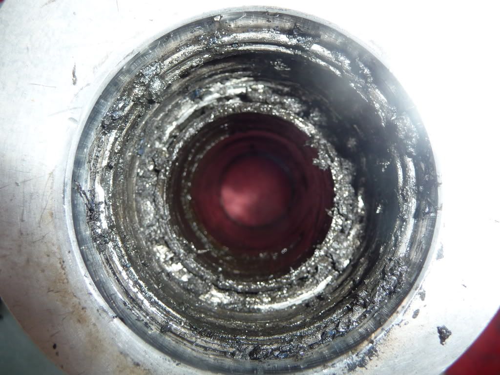

Once I got back to the pits I noticed the grease protruding out of the carrier and cooking on the carrier itself :shocker: .

Wow I thought mine was bad. In my Raptor 700 my chain kept on getting loose and here my left side axle bearings were demolished. The middle shaft was engraving into my carrier and my axle was misaligned, which rubbed on my brake rotor and brakes and ate them away. Now I just installed new EBC pads, Galfer wave rotor and a new Gibson Carrier. Looks and performs way better.

Your axle don't really look that bad. I think it should be fine. Glad this happened then and not another lap or 2. Either way it really sucks for sure!

Yep, 3 month old axle down the drain. All it is now is a metal shaft with threads, splines, and grooves.[/b]
That sucks Cam. Did you call RPM to see if they can do anythong with it?
Maybe they can fill it in and then run a lathe over it to make it true again...just a thought.
