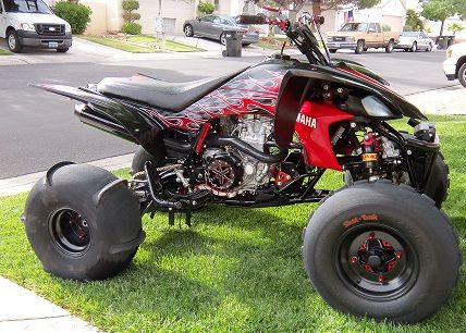

Does anyone have the paperwork or know how many turns or clicks on the screw equal what size leak jet I'm trying to tune my yfz and it's been a pain
Come on guys someone has to have some knowledge about this I'm playing hell trying to get my bike tuned in
Just screw it all the way in. That should emulate a blocked off leak jet. Then, you can unscrew it, a 1/4 turn at a time, until it starts to rev how it's supposed to. You're just going to have to tune it. There's no magic to it, and no perfect setting for every engine. Just gotta try and tune it in. Tuning an FCR is a process, but if it's done properly, you'll have a lot more fun every time you ride, and the confidence of knowing that you did it yourself. Have you read through the jetting guide on the forum? If not, I highly advise that you do. Good luck.
