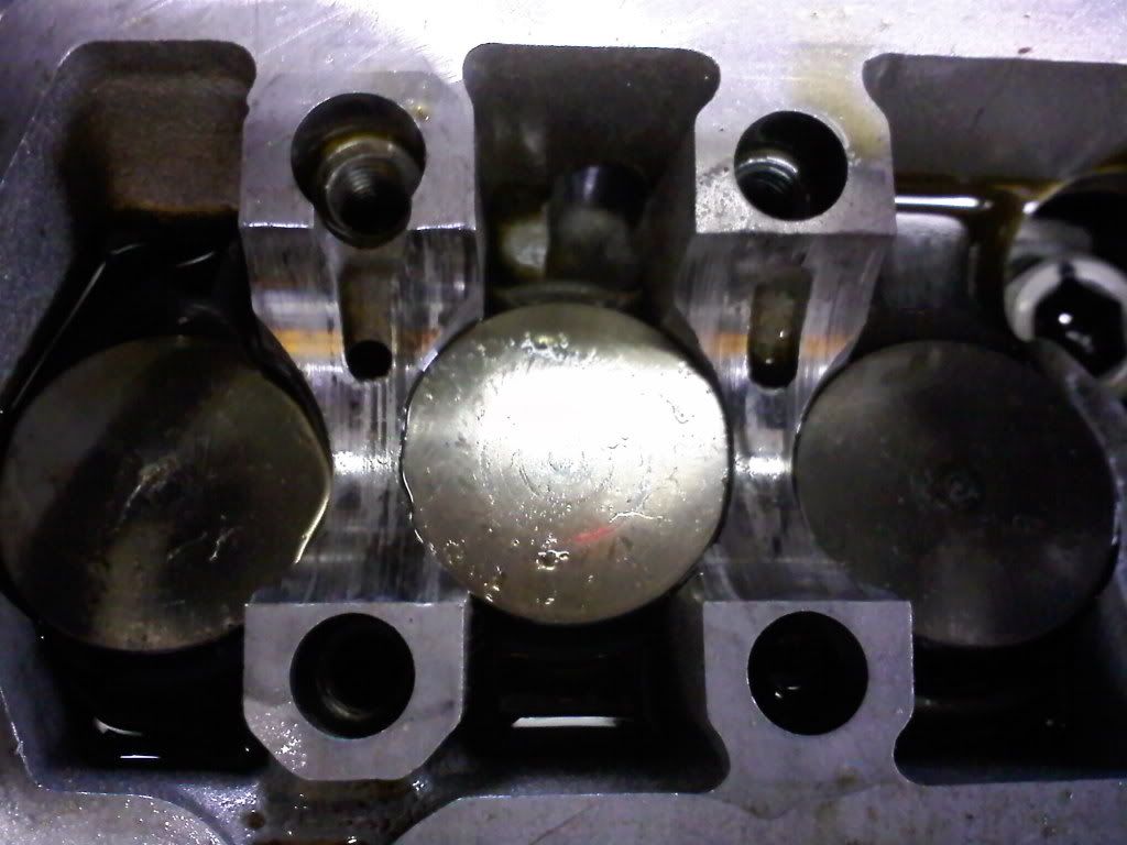

I have a fresh motor in my yfz about 40hrs on her crank,piston,cyl, and heads by ttm so today I went to check my valves and found the intake cam and cam/cradles scored like it ran out of oil see pics. I dont baby my bike in anyway but am always 110% on top of maintenance. I drained the oil and ran a magnet threw it and came up with no metal shavings bolts were tight on the cam tower, it had plenty of oil and, the exhaust cam/cradle is perfect. So I have no idea how this happened and am about too lose it :angryfire: because my head I just spent 400$$$ on 2 months ago is trash
PLEASE HELP ME FIGURE THIS OUT racing starts in 14 days

QUOTE (05 YFZ450#117 @ Mar 11 2009, 03:34 PM) index.php?act=findpost&pid=756594
bolts were tight on the cam tower[/b]
how tight?
it looks like they were too tight...and that oil is pretty dirty?
i'd have to agree with... adam is it? Mr. Captain Obvious? lol
but yea, 7.5 FT. LBS. aint a whole lot, and your oil looks REALLY dark

did you send your head to ttm and get yours back or did you just swap heads.
the bolts were all torqued to 7.5 with a snap on tw when I put the motor together and the oil was changed 4 rides ago it looks dark in the picture because there was no light
something doesnt add up then...
when you torque them, do you do a final check to see if you can spin the cams by hand? I've come across several torqued cam caps that wont allow the cams to spin freely.
7.2ft lb is the spec but .3 of a difference wont burn your head up like that. can you check the cams for runout?
at the end of the day, you need to try and clean those journals up as best you can...gently.
are there any gouges in them or is it just visual marks?
What kind of torque wrench did you use?
Says Snap-On
I wonder if he confused lb/ft with the meter side of the tq?
I'm wanting to know how accurate the 7.2lbs is/ was. Most ft lb wrenches only go to 10lbs, and aren't very accurate at 10lbs... much less anything less then that.

It was a snap on in lb/nm torque wrench and went to 20nm aprox. 15ft lbs The bolts ex/in were torqued down to 10 nm which is spec. I didnt get any numbers confused i have rebuilt a number of these motors and know how to use a torque wrench the exhaust has no damage and was set at the same spec. the engine ran strong with loads of power after the rebuild but about a week ago it was a little harder to start like the battery was going dead or there was a strain on the motor

those cam DO looked overtightened, i dont know if it was you or the wrench, but i think something went wrong when you were tightening it. It only takes a little more to make em lock up. did you spin them by hand?
no but i turned the motor over via the flywheel but what i dont understand about your statement is the same wrench at the same setting at the same time was used to torque the ex cam down and that cam and cradle is perfect no damage.
