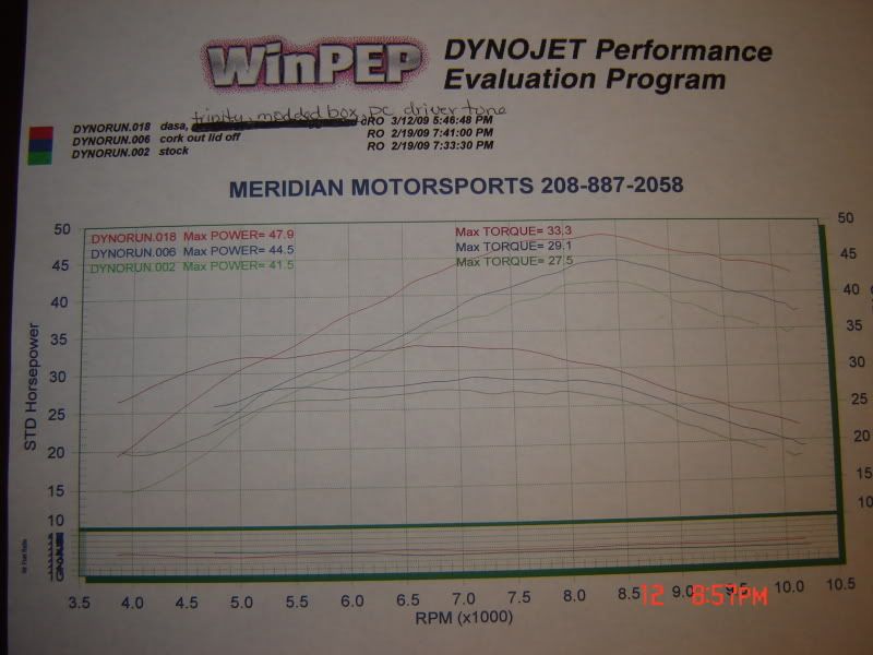

Graph shows stock vs. cork out lid off vs. dasa pipe, trinity intake(modded box), pc5 tuned by yours truely. Enjoy. Dasa pipe and power commander were both purchased at Fuelatv.com. Intake straight from trinity. I really like this intake setup. Bolted right up and the filter is just right.
Almost 6 full horsepower, nice.
how was the box modded? nice numbers

how was the box modded? nice numbers[/b]
2inch holes on the opposite side of the exhaust and on the back. Pretty much cheesed it up. Showed gains of about .5whp across the board, and some nice torque.

So what your saying as far as the airbox is you just drilled holes in the air box.Still used factory filter and lid still on?

I have the DASA complete system,Twin Air filter,lid removed and PC5 installed.Mine is mapped for the GYTR pipe and the other mods.Was no map for the DASA system on powercommander.com at the time.So thats why I used the GYTR pipe map.
Is there a source for a map with the DASA system that you know of?Thanks.

I can tell you this. I dont have the bike anymore but I started with the gytr map and then took out about 7% fuel across the board at 80% and 100% throttle and the map was real close. The map was a little rich for this setup. Hope this helps ya.
Im located in Boise Idaho and I tune alot of machines. This was my first yfzr and it was very easy to deal with.
