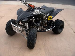

Started off over a year ago with a stock 04 LE YFZ minus a GYTR pipe:
Last April: Added a pro armor bumper and nerfs + DFR graphics:
Recently: Added A Arms, Axle, Raptor 700 stem (+1 inch), Flexx bars, Shaved Fenders, and some ITP rear tires.
Let me know what you think...

nice yfz. i like the green lower a-arms, thats a sick color combo. and of course DFR rocks!
Nice quad, you'll like the Flexx bars a bunch. They're real forgiving on the wrists, elbows and shoulders. I noticed you're running the softest elastomers on them, don't be afraid to try the yellows or even reds for rougher applications.
BTW, what brand a-arms are those?
I've had the flexx bars for a little while now and they're amazing. I bought em used so they came with just those elastomers on em, I like how much they flex right now though.
The A Arms were made by a friend based off of LSR a arms. They use 1/2 inch race heims instead of ball joints.
Thanks for the comments..

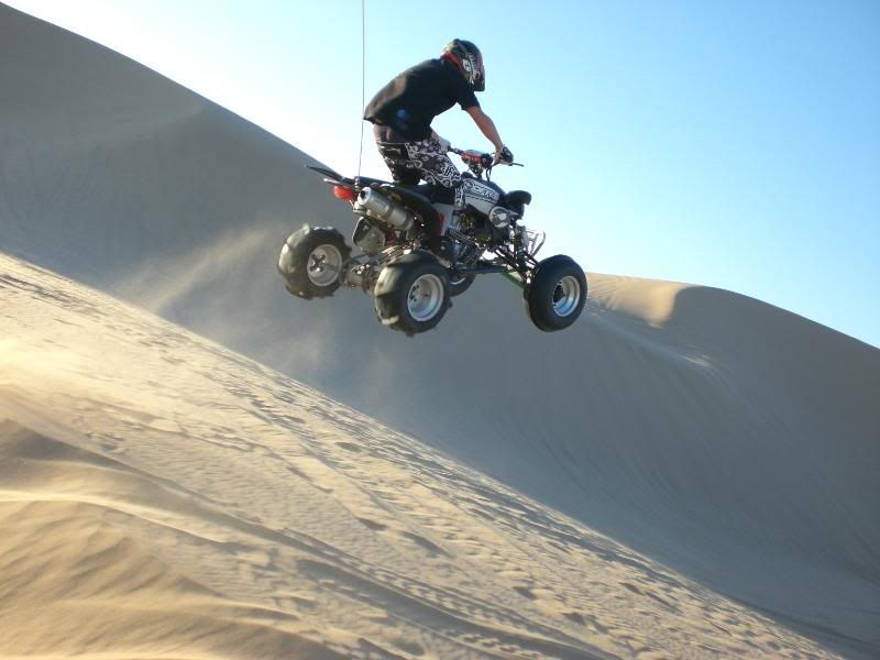

Got a few more photos out at Gordons Well this weekend... Plannin on powder coating the bumper black and the grab bar green sometime soon. Also want to get a green Flexx bar pad..
